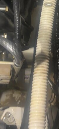

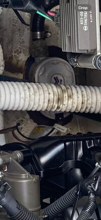

Depends on if you have the stock bilge pump or not as to how easy it is. The original manual would clarify, but I know on my 2012 when the bilge pump is switched 'on' it is actually being switched to 'auto'--it senses if there is water and keeps pumping if there is some there. Once the water is gone (e.g. the impeller spins freely), it turns off. It 'tests' every 5 min or so by spinning the pump to tell if there is water there or not. Your manual should tell you what type was stock.
Then the question is whether the pump was ever changed from stock. There are pumps that support 3 positions (off, on, auto) and some that just do on/off (you use them typically with a float). So if the pump was changed, it will depend on what type of pump replaced it and how it was wired. Still very DIY-able, I would say, but certainly different levels of complexity...
So, do you know if the pump has been changed?
I will have to look and see -- I got the boat with 39 hours (1 previous / original) owner, on it so I don't believe it was replaced. It looks like the original

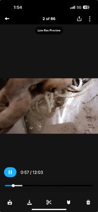

For reference, water is coming in here, I used my gopro.

Also, your bilge pump looks to be the OEM pump. FIND OR DOWNLOAD YOUR OWNER'S MANUAL. It'll tell you how your bilge pump is supposed to work, and how you should utilize the button on the dash - that still may not be correct, sadly, but the manual should tell you how to test it, and you can report back to us. I'd also pull the pump and check to see if the screen on the bottom is filled with debris. There's plastic tabs on there to allow the body to be removed - should be pointed out in the owner's manual. @tdonoughue described it perfectly as to how the bilge pump is supposed to work, so you need to cross check that your model operates that way, and make sure to test it to verify that it's working, working PROPERLY, and works in the manner laid out in the manual. If any of those 3 things isn't happening, let us know.
This is what mine looks like. But does this water ultimately flow to the ski locker / bilge in the engine bay?
If it does, it would make sense. I have no issues on plane or sitting, only when throttle back from plane to no wake
Yes, it fills up the anchor locker until it overflows into the ski locker and/or bilge. All of those areas eventually lead to the engine bay, which is necessary, as that's where your bilge is located. That pic you took looks like it's showing the divider is in place in your anchor locker as well, which should be removed to make things easier for you. Should be 4 phillips screws, if it's like mine was.

Did you get the owners manual with your boat? If not you can find it here;
Looks like there is a fair amount of crap in the bilge from your pictures, put the plug in your boat and take 5 gallon buckets of hot water from the house with a lot of dawn dish soap in it and dump that in the bilge. Enough to cover the bilge pump and the go tow your boat around for 20 minutes or so on city streets, the sloshing action will help to get that solution in places you cannot reach. Come back and pull the drain plug. Put the plug back in and refill with hot soapy water and use a soft brush and brush everything down, get under the engines and such, ski locker etc then pull the plug. Then raise the nose of the boat as high as you can get it and rinse from ski locker back, including the aft bilge, if you can get hot water from the house even better. Leave all the compartments open and let air dry completely. Then spray the engines and aft bilge with a light coat of silicone spray, be sure and hit the electrical connectors. Just a light coat! This will leave your bilge looking and smelling the best it can, and the silicone will disperse any water / moisture in the future and make it look nice.
Be sure and pop your bilge pump out of its cradle to make sure there is no debris in there after cleaning.
