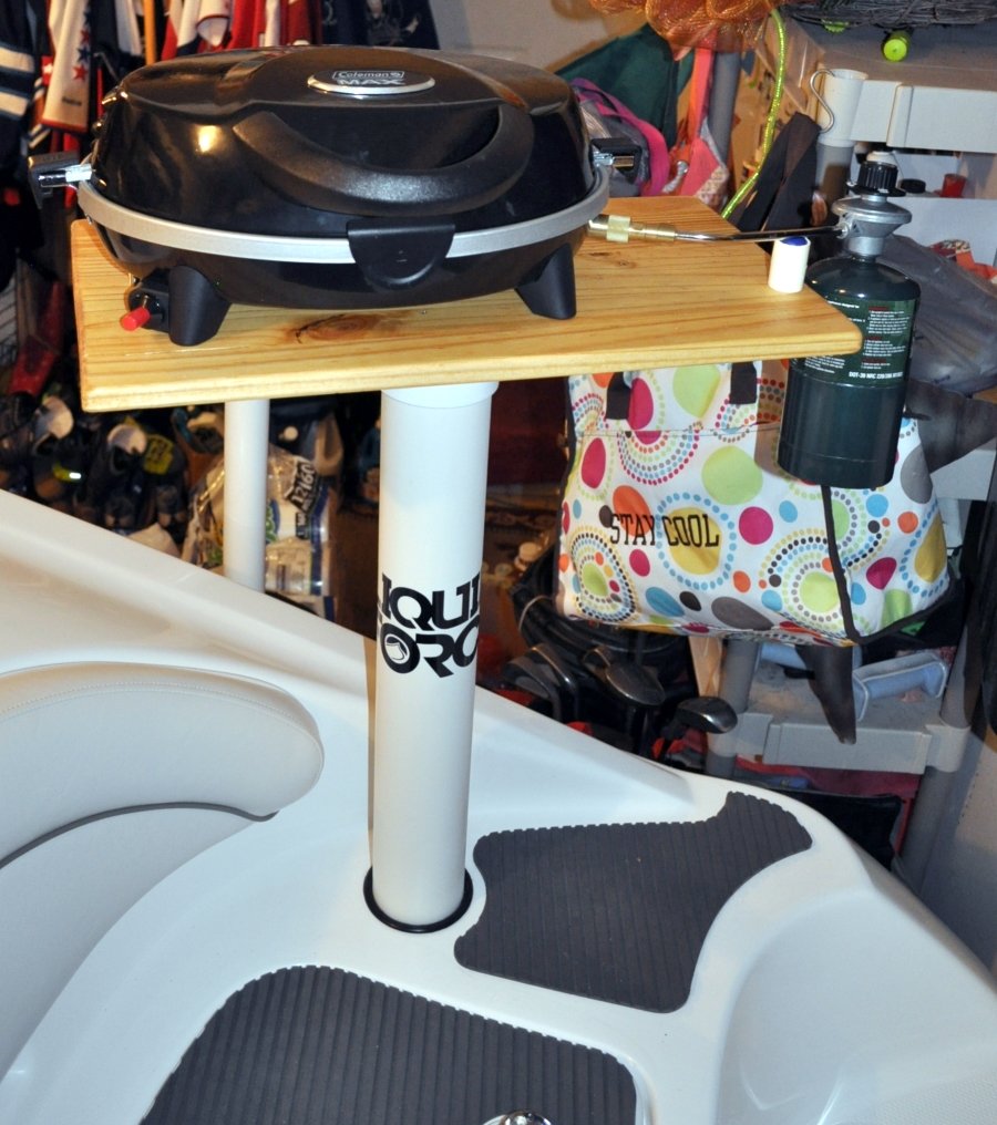

Here is how I did mine more pictures in my media.

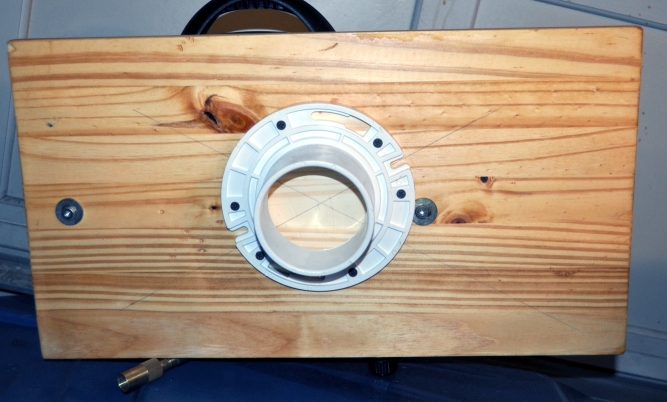

I took a cheap single burner grill mounted it to a board (by drilling two hole with bolts left and right of burner)

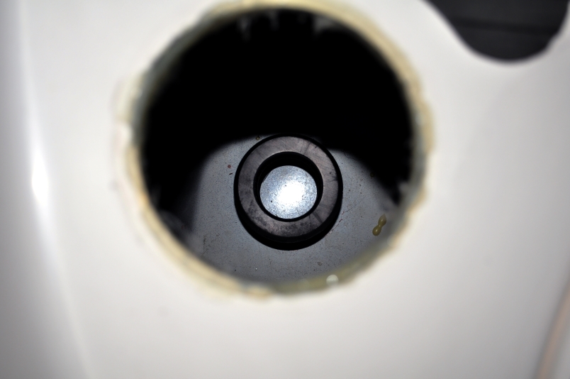

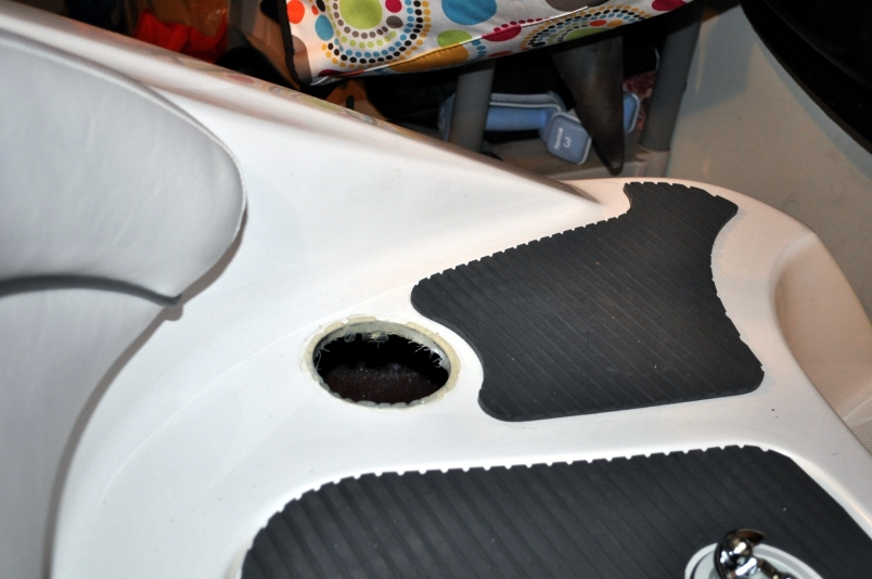

Took on cup holder out of swim platform temporarily

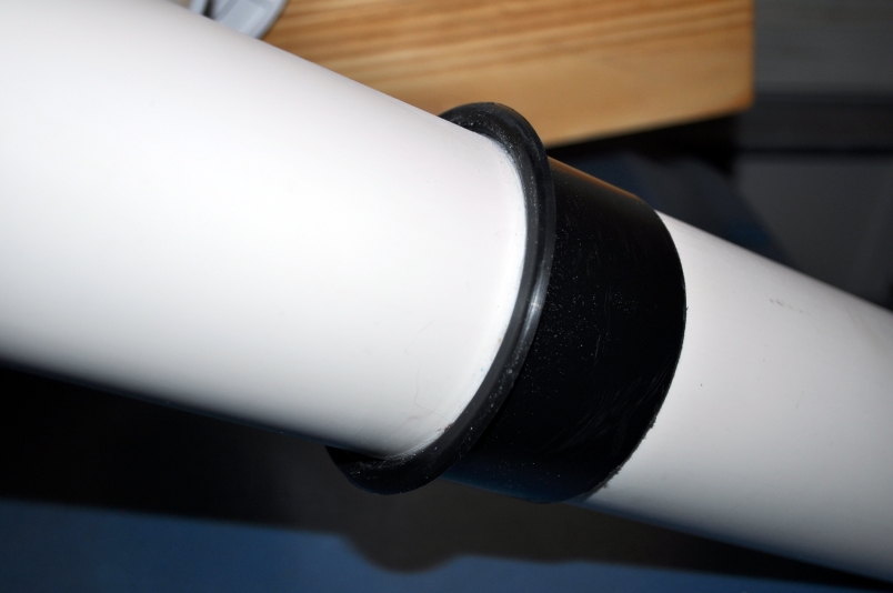

Epoxied 3" PVC rubber grommet in bottom
Cut 3' long 3" schedule 40 PFC
Cut bottom off on extra plastic cup holder and slid over PFC (heat gun to get it to expand enough) and glued in place
Screwed 3" PFC toilet flange to bottom of board
When I want to use the grill I take out cup holder slide PFC in hole and put grill on top.
View media item 2244 View media item 2246
