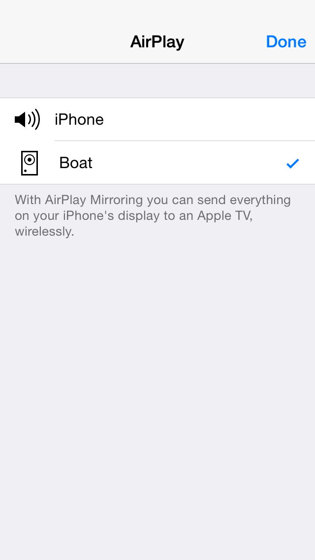

Device
Connect to Boat Wifi
Choose AirPlay to Boat
Working

Yes, the first time you connect to the WiFi network you enter your IP and Subnet mask in the Static tab and from then on your good. I use Spotify for music, video of the simple process attached.
