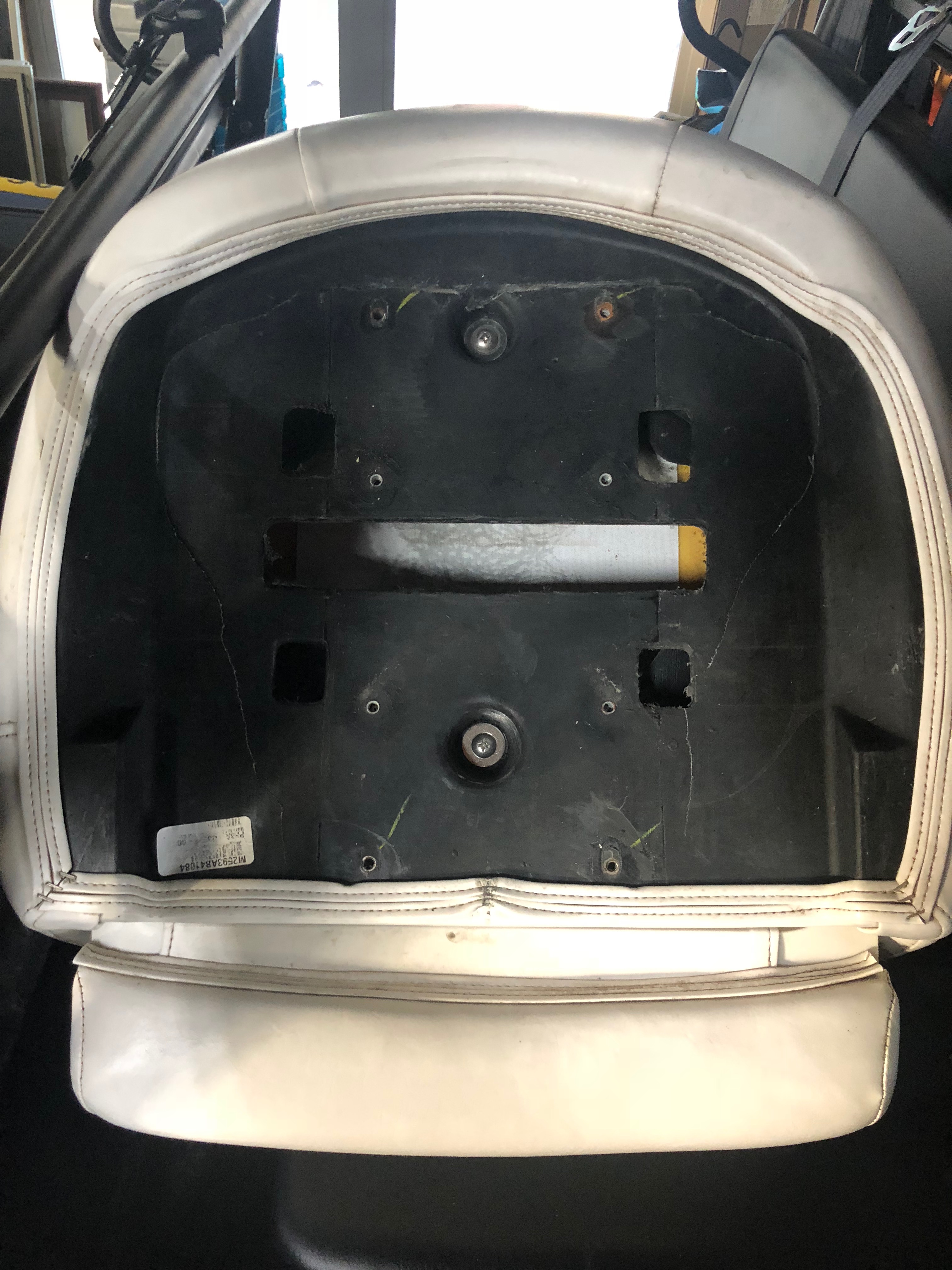

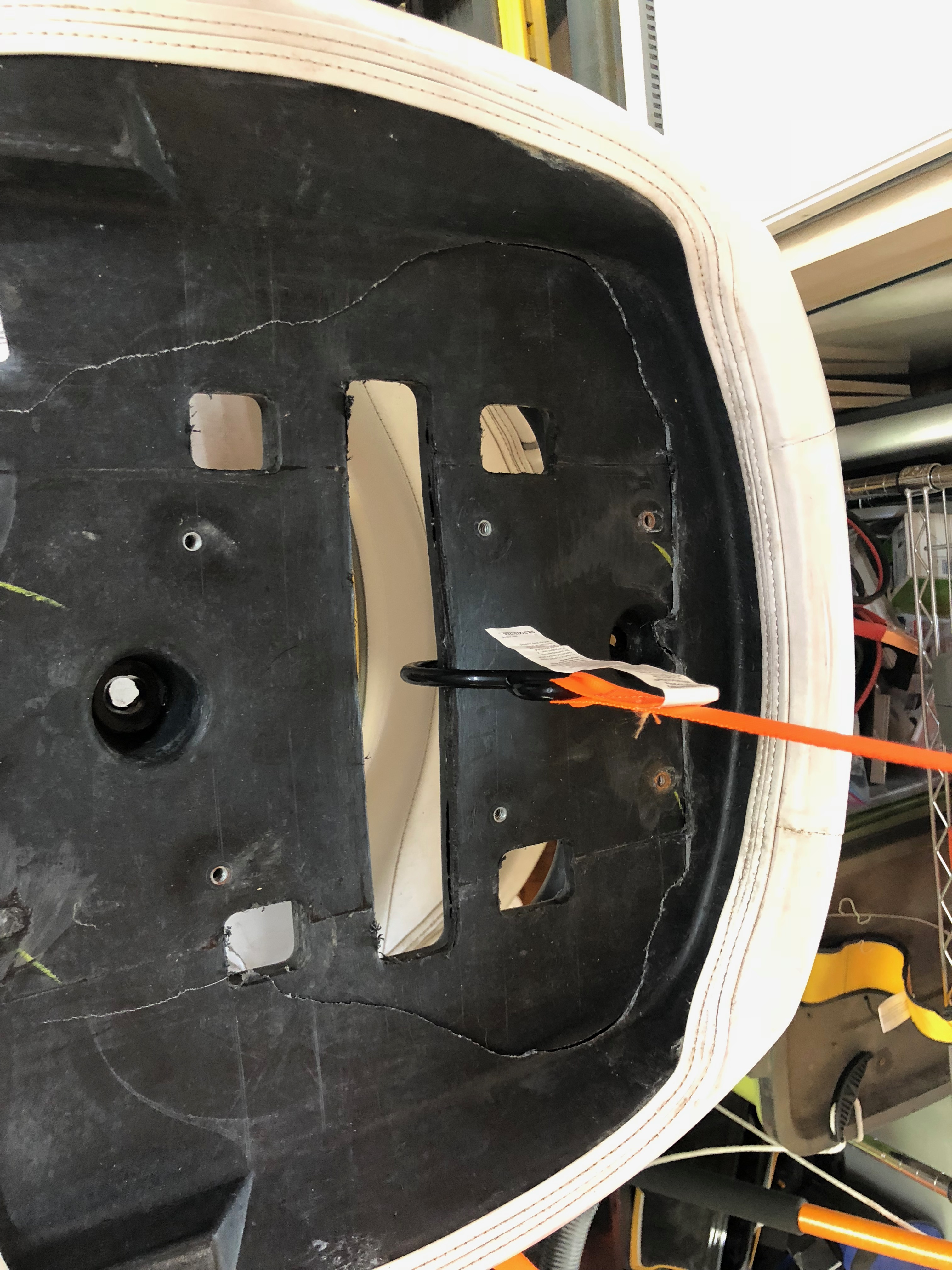

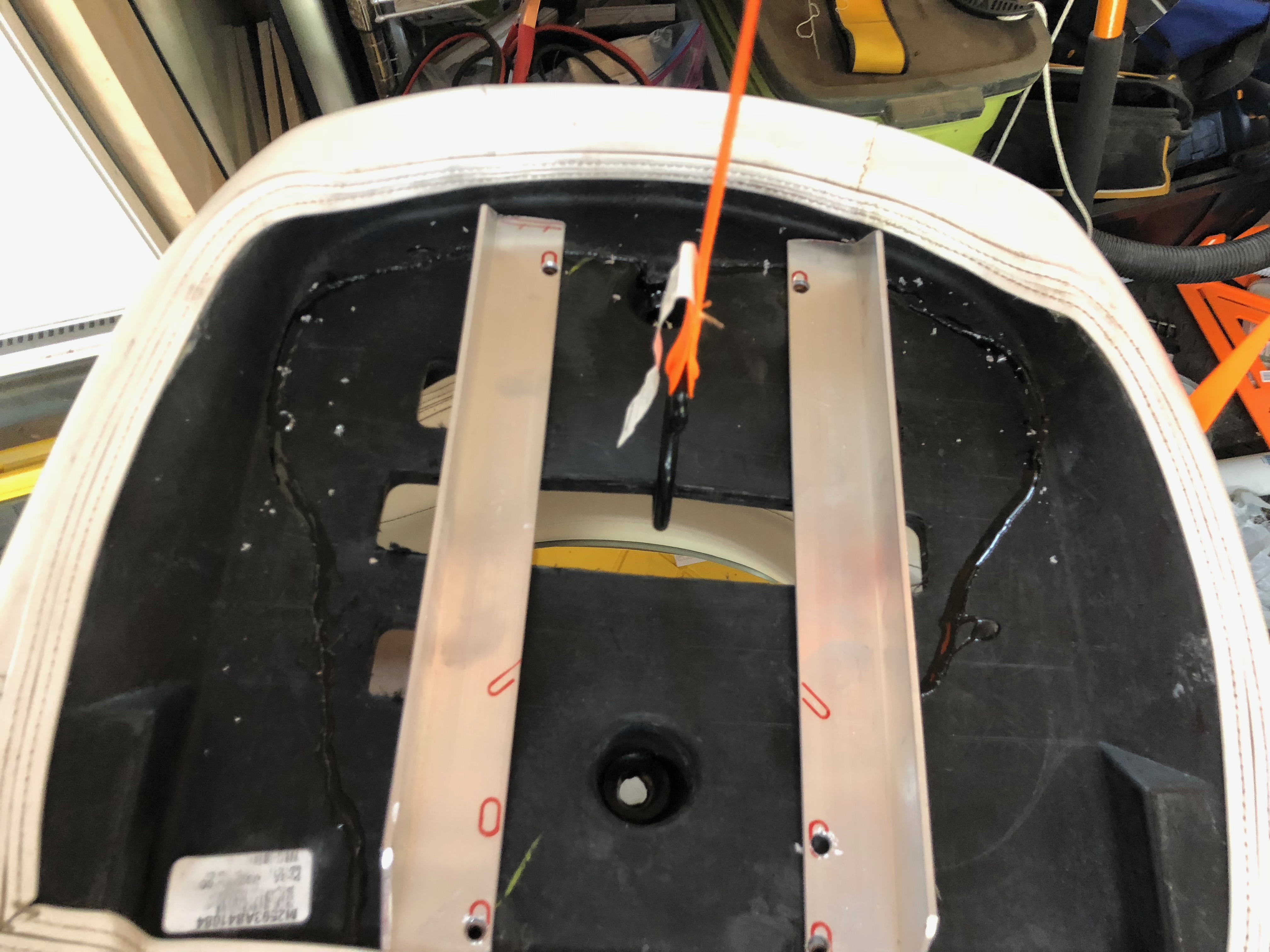

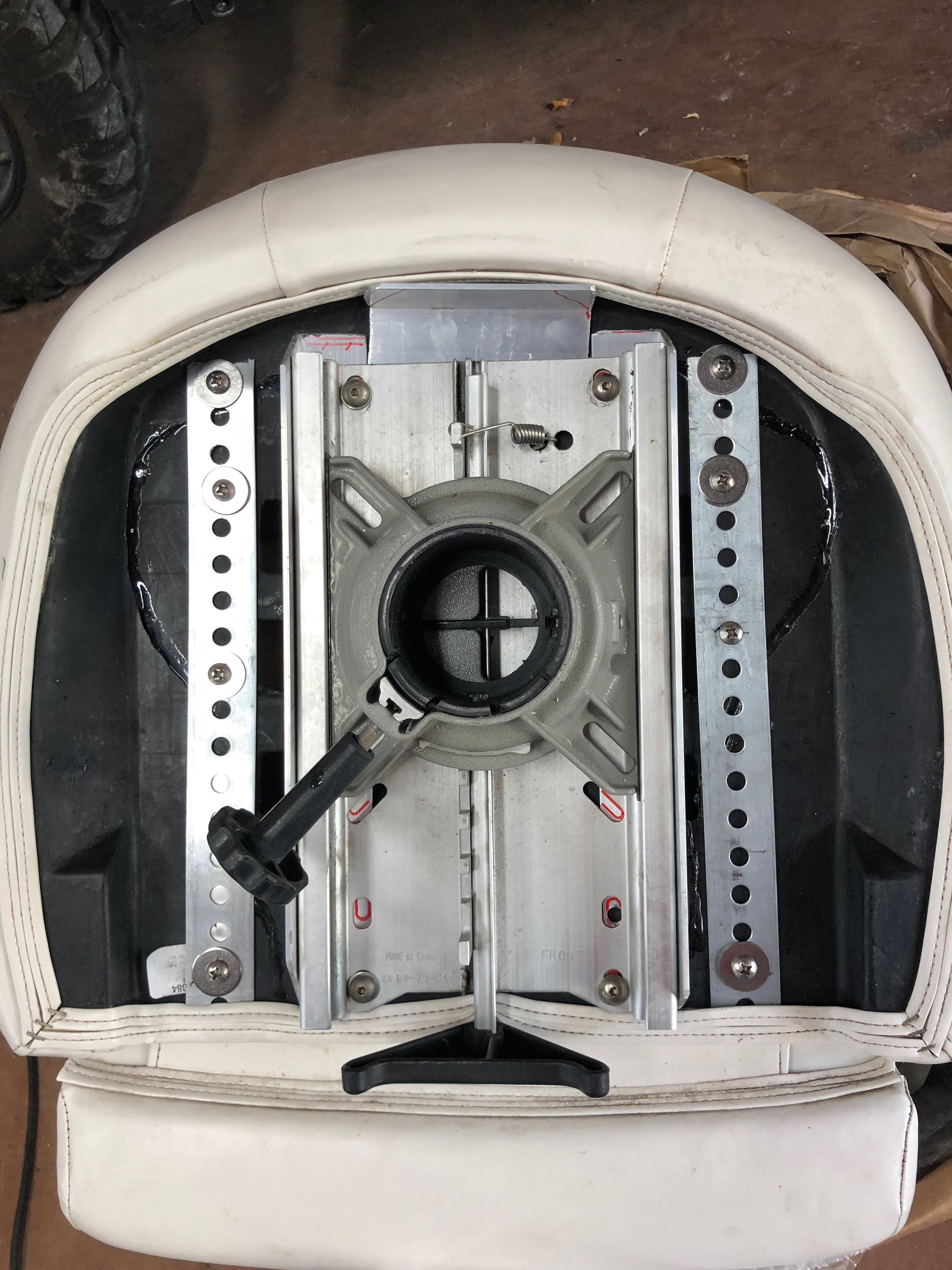

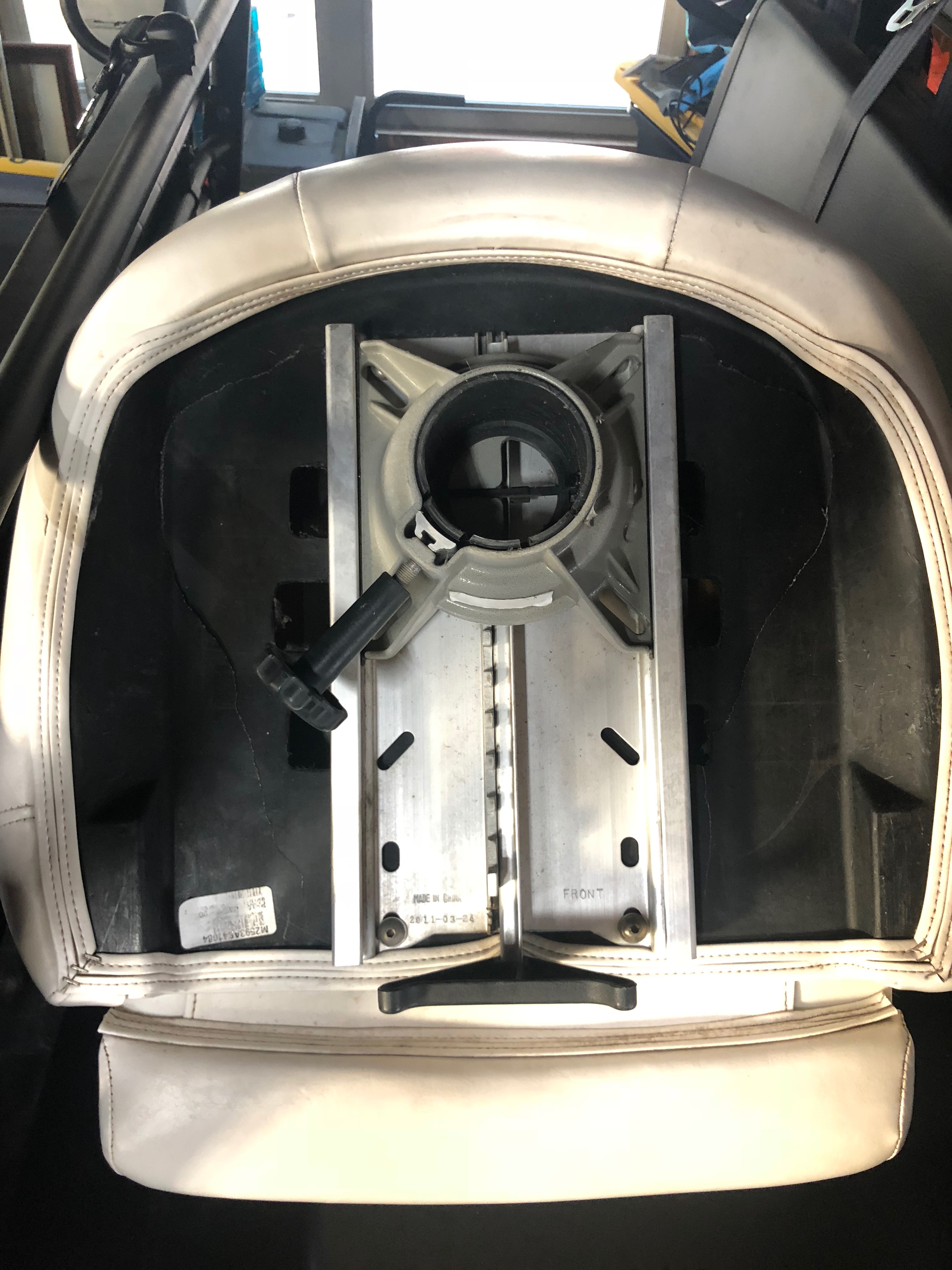

So I finally realized why my captains chair was so uncomfortable and was preventing access to the starboard rear storage, the seat base was completely busted. Searching for solutions I found this appears to be a fairly common problem on our boats, but there were no real solutions other than to replace the whole seat. At the princely sum of $600-700 this was not a road I wanted to go down. so I pulled the seat and removed the mounting bracket and the main cushion. cut so aluminum L stock down to reinforce the seat base and galvanized straps as well. I hind sight I should have done some additional cross bracing, but initial testing has held up OK. Ill let you know how it goes on a sea trial later today. see the pics below: hope this helps some of you wish Yamaha would have built these with a metal seat base.

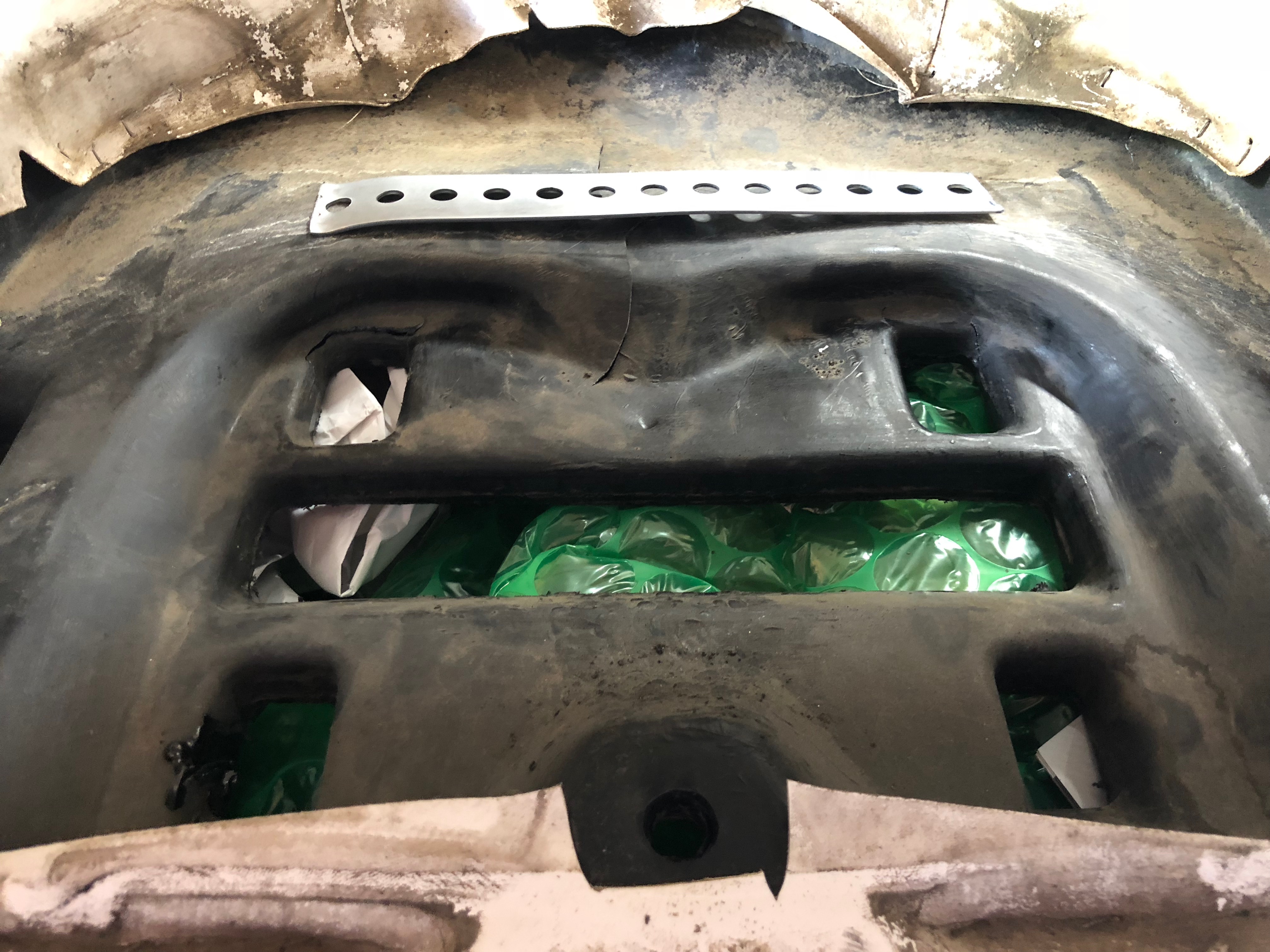

Mine just broke for 2nd time. First time I fixed with wood. Will have to tear it apart to see where my engineering degree (Kmart going out of business sale) went wrong.
Pulled chair to look and evidently the chop/bump was bad enough to make 1/2 inch of plywood push past the molded plastic. Think I’m going to try a different seat also...likely avoiding Wise as I believe they manufactured this one.
