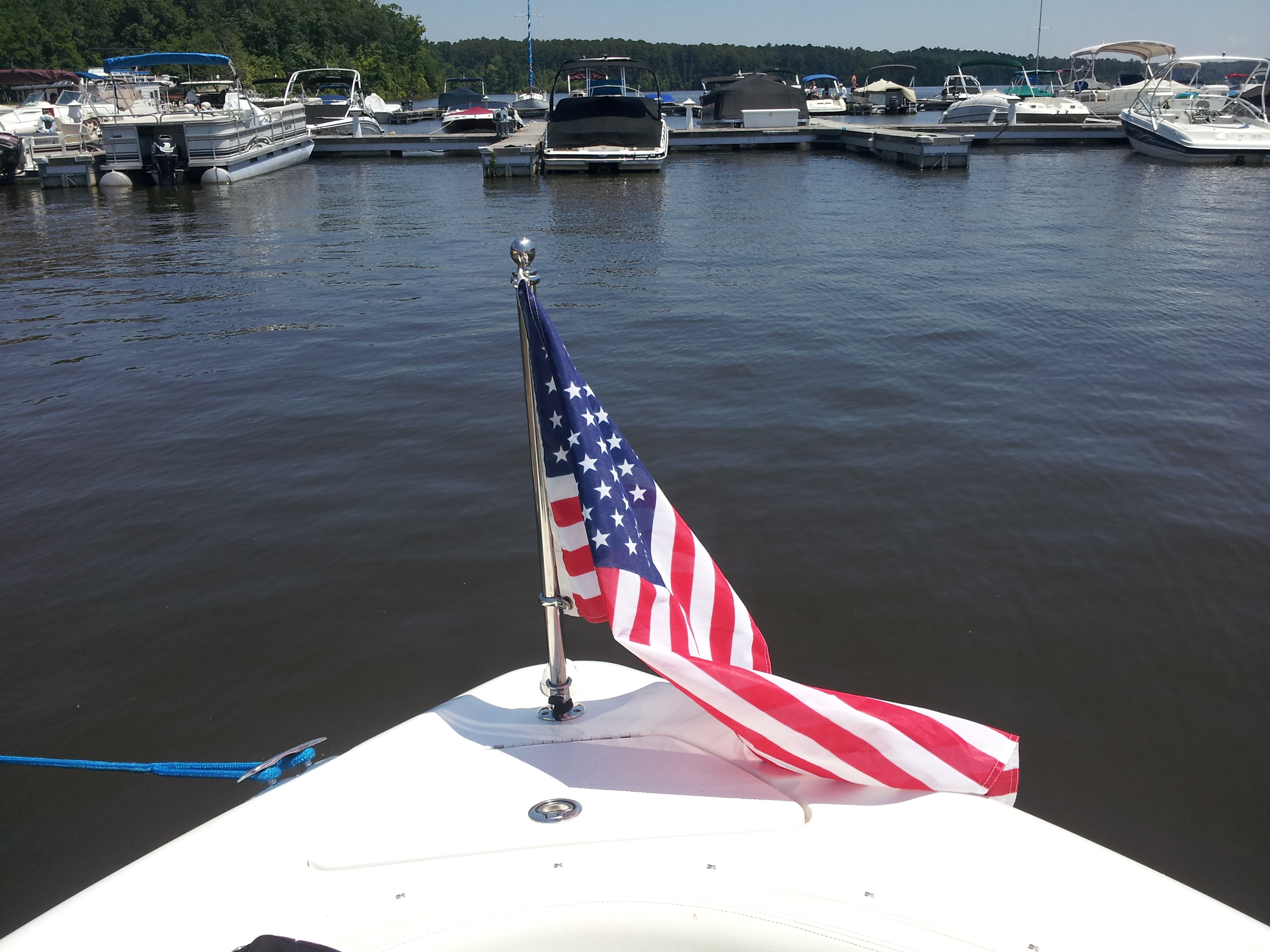

Right. Those of us with AR240's and SX240's don't fall within Rule 30(e), therefore we are subject to 30(a), still. That requires the day shape on the front of the vessel. That is, if we are in navigable waters (which, up here on Lake Conroe, I am usually not).
But I was just looking at all of the diagrams I have seen of that, and I have no idea how one would secure a ball day shape there...

You are completely correct. Vessels SHALL display the shape. Annex I allows you to use a "reduced" size shape for vessels less then 20 meters. You could tie a black tennis ball to your stern light post and that would suffice. However, I've been a CG Boarding Officer for 20 years this coming June, and I nor my shipmates have written a recreation day shape violation.
