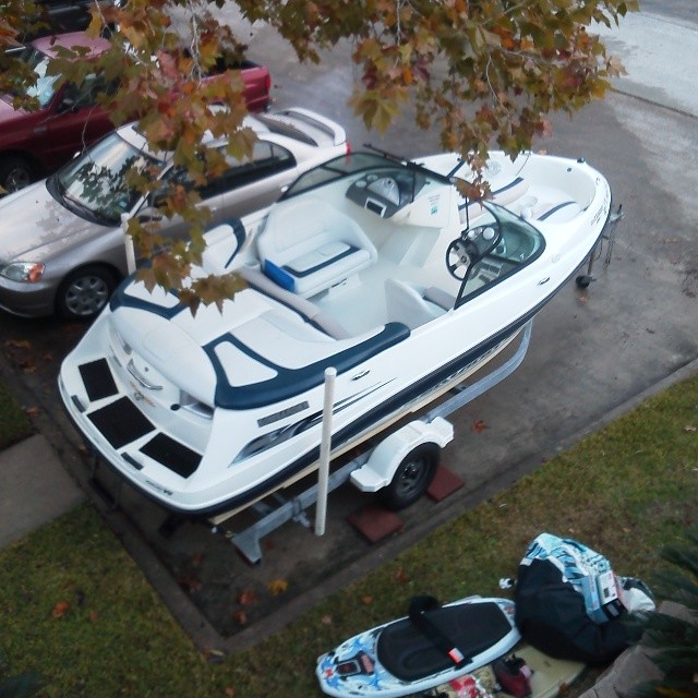

As for Cobalt's, my 2016 R5 swim deck is an integral part of the hull not a bolt on piece. Side note, I've always hated the look of the bolt on swim decks and Yamaha's integrate swim deck was one factor in the purchase of my recently traded-in 2007 SX230. Back on topic, my R5 is listed at 25' 8" long which includes the 2' of swim deck hanging past the side of the boat. I knew that measurement when I bought my Cobalt and therefore I thought it compared well in size to the 24' Yamaha's.
