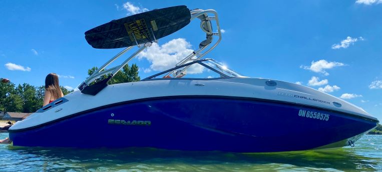

Congrats on the boat! and i can confirm (at least with rotax powerplants anyway) that leaving it in the water all season just demands extra cleaning. I bought mine June of this year and was planning on trailering it. My parents surprised (college grad present) me with a slip down the road from our house (Lake Ontario) and I dont think i will go a summer WITHOUT slipping it. I took it out once a month just to clean the hull and interior.
I noticed some yellowing of the white hull but it didn't bother me much as it was always in the water. Some growth on the metal parts of the pump but nothing that cant be washed away. Never noticed a hit to my performance. Mind you, what we are experiencing is more of a "colour change" than it is a growth.
I think if you do a monthly cleaning/wax touch up you should be fine. At the end of the year, wash the hull with an acid compound (Toilet bowl cleaner worked for me - 9% Muriatic acid or HCl was the main ingredient in both toilet bowl cleaner and hull cleaner. I saved my pennies) and rewax/seal your hull and you should be fine.
Mind you, this is coming from my little 4 months experience LOL. But thats 4 months free if mooring related issues none-the-less!!
