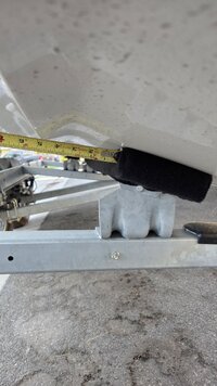

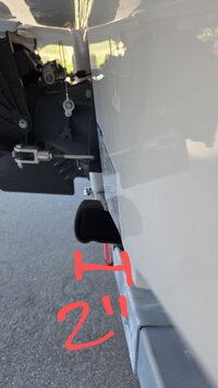

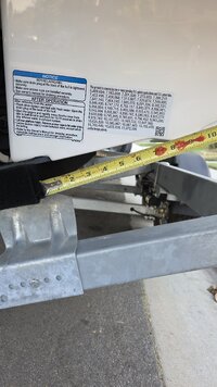

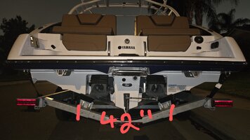

Are these trailer bunks spaced properly (see photos)?
- The rear bunks are 7" from the strakes.
- The front bunks are 3" from the strakes.
- The rear of the bunks are 2" past the transom.
- The rear bunks are 42" apart (outside of left bunk to outside of right bunk). For a boat with a 102" beam, 42" bunk spacing seems narrow.

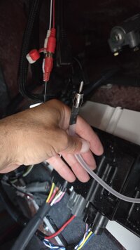

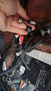

The connections in the photos (USB-A and antenna possible?), behind the helm, were neither connected to anything nor where the rubber boots closed. Is that antenna male plug supposed to be plugged into the female plug? Is something supposed to be plugged into that USB cable?

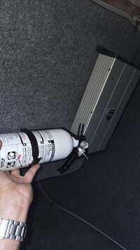

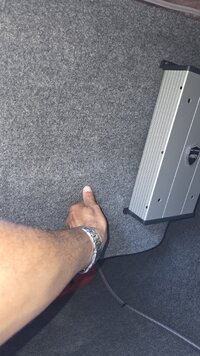

Those with a 25" sport boat, where/how did you mount your fire extinguisher? It looks like there is a horizontal piece of wood glassed into the panel in the storage compartment (see where thumb is pointing in photo). Is this a good place to mount it? It would have to be mounted in a horizonal position I don't know if that is against the extinguisher mfg recommendations.

I would need to take a look at my trailer and get back to you on the bunk placement, yours definitely looks odd. I'll take a look in my helm at all that stuff as well. Won't get back to you until next week since Monday will be the next time we get it out of storage. I honestly didn't care to mount my extinguisher yet, sucks there's not a good spot, So I laid mine in the helm next to my bucket of random things; it's secure and accessible. I thought about fashioning a securement system of velcro and 3M adhesive but maybe down the road. Where you are pointing would probably work though!
