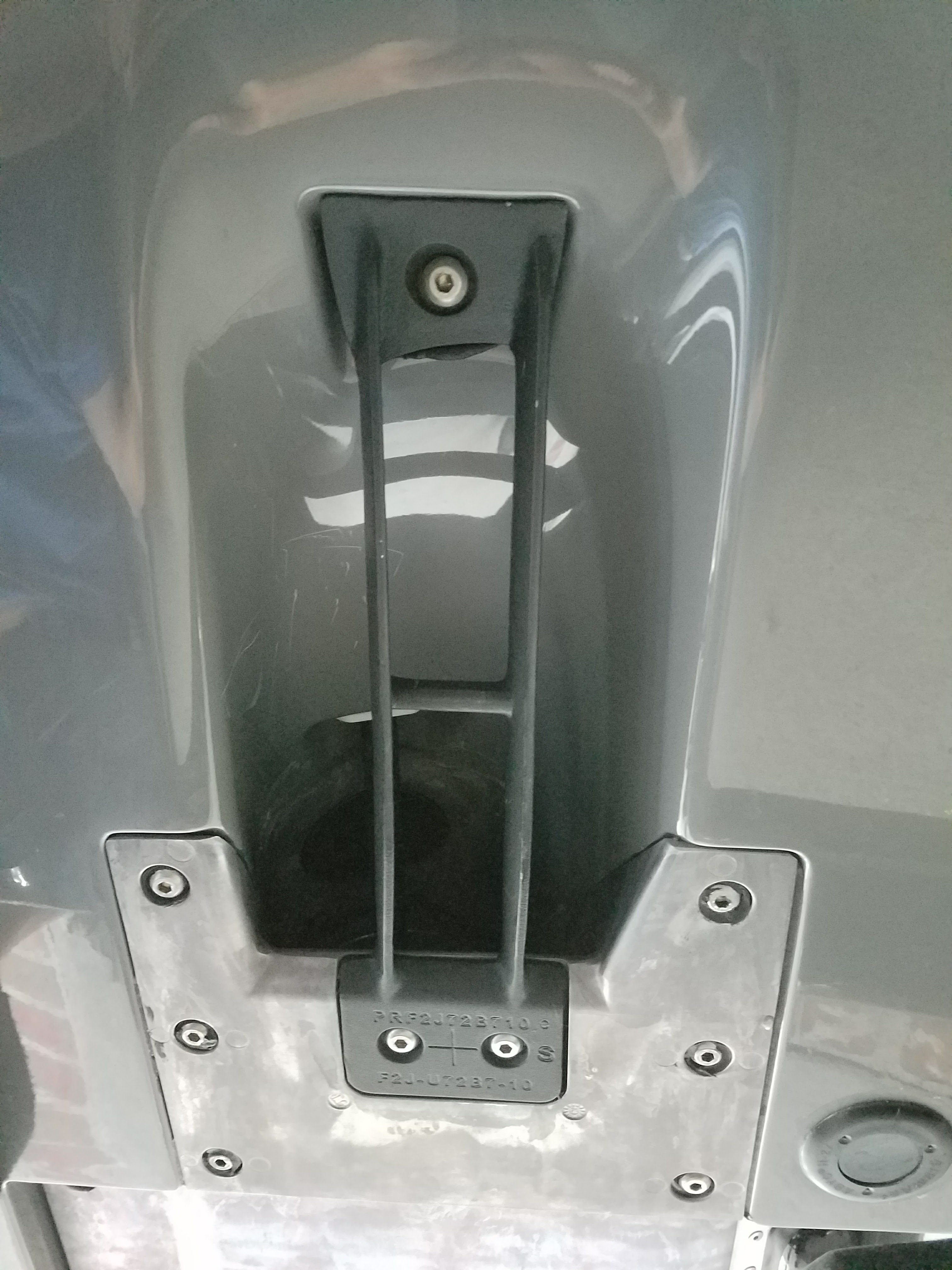

Ok since I can't leave anything alone and I have this insane desire to make every mechanical assembly better than it was originally designed, I'm thinking of trying the unthinkable. lol.
I'm going to remove the intake grates on my brand new boat I've had in the water 3 times now. haha. I'm going to machine blocks of aluminum to bolt into the spaces the intake grates leave so that there's absolutely no bumps or voids in the flow to the pumps. Basically it will be the same as if I cut the bars off the stock grates and just left the mounting blocks. (The grates cost about $60 each so actually just chopping the bars off the ones in my boat and ordering new ones in case it doesn't work wouldn't be that big of a deal. I wouldn't even have to take them off to do that.)
So why would I do something so seemingly stupid you ask? Because I like to learn. Yes, I FULLY understand that there is an increased risk of sucking small animals and tree stumps into my jets, but honestly how much do the stock grates cut down on those possibilities anyway? There are only two bars on these grates, they're pretty much wide open actually. You could easily suck up big enough stuff to wipe out an impeller anyway. So I don't believe the stock grates are really cutting down those chances very much over not having any at all. They certainly aren't going to stop or reduce the chances of sucking up a rope. And it can be argued that there's more chance of the sucked up rope breaking the grate and having it sucked up too, vs. not having a grate in the first place. And as far as human safety, if you're stupid enough to have your body ANYWHERE NEAR the intake of a running jet boat, you probably deserve to have your arm swallowed up and spit out. Is having no grates on a jet pump intake more dangerous than a standard prop? Oh hell no!
Seaweed- Ok I've already had so much seaweed stuffed into the grates on my boat that I had to spend 15 minutes cutting it out of the grates with a knife. You can easily reach all the way down to the grates through the cleanouts, but it's damn near impossible to push the seaweed back through the grates when it's wrapped around them. What happens in those situations when there's no grate at all? I'm thinking it would be 1000 times easier to simply push the seaweed back out of the intake, that is if it doesn't already fall out by doing the reverse trick. So for seaweed ingestion and removal, I'm thinking it's got to be better. The grates certainly aren't keeping the seaweed out of the impeller, and not having grates isn't going to change that much. Maybe if it has a nice smooth path into and through the pump it might be able to eat more seaweed without getting plugged up even.
Performance- Yeah, I'm always looking to get my equipment running at it's top efficiency, whatever it is. Will not having a grate in the intake help pump loading? I would certainly think so. As far as the physics of it, I don't believe anything in front of any kind of pump wouldn't end up being a restriction of some sort. The only exception to that might be something that directs the flow into the pump more efficiently because of design limitations of the application.
That brings me to the "Top Loader" question, has anyone tried it? I understand the idea of a vane or wing that directs water upwards into the pump. But if done wrong, it can obviously be a huge drag on the bottom of the boat. It seems that the top loader theory is more for slower speed cavitation and it doesn't do much for top speed. (I'm more interested in top speed or higher cruising speeds than out of the hole acceleration.) If I'm bored and have the time, I may make up a wing or vane to weld onto the stock grates to see if I can make a top loader myself. I don't think there's any aftermarket grates for these boats and obviously two watercraft grates, even if they bolted up, wouldn't work on a twin engine boat.
I also think boats are way different than watercraft simply because of the angle of the bow when accelerating. When you're plowing or getting out of the hole, the jet intakes are more "open" to the incoming water. When you're up on plane, the intake openings are much flatter to the water. Have you guys noticed that putting more weight in the front of these boats slows them down? On most prop boats, (in general) you want to get your passenger or cargo weight towards the front of the boat to help it plane flatter. I've already seen on my boat that too much weight at the front of the boat slows it down a lot. Is this because you're getting less pump loading? I have a feeling it is. Lowering the front of the boat puts the pump intake flatter to the water instead of letting it "scoop" a little bit. Too much "scoop" of course would slow you down though. Hmmm. so much to think about!
Sooooo, I haven't done any chopping yet, but I'm gonna lay under my boat today and stare at those grates for awhile! If anyone has ANY info or experience with any of this, let me know. Like I said, worst case is I have to buy a couple of stock grates to put back in it if I chop up the ones I have. Or also worst case- if I suck up something that destroys an impeller, I'll just end up looking into aftermarket impellers or changing pitches anyway. I just don't think there's much difference between the stock grate or no grate in being able to suck up something that can damage an impeller. Devil hates a coward!!! haha.

Very interesting! One thing I've learned with these boats - you almost never know what you going to get, until you try and test it out.
I would not be concerned about safety too much, you can still stick your arm through the grates etc.
Keeping large-er objects from getting sucked in - yes, that is a bit of a concern, you would not believe what kind of stuff has been found stuck in those intake grates! I would be more concerned about cracking the intake tunnel if something large got in there and could quite pass through, say... a tire. LOL, I think @buckbuck actually found one that way.
As far as intake and speed - not sure how much to would help, but could NOT hurt.
The bow down attitude speed reduction is notable, but that is likely due to more hull contact with water, not the intake angle.
Jet skis can benefit from top loader, but in the boats I'm not aware of any evidence of it due to larger displacement. But again - not many tried. If I were to mess with the intakes, I would probably try a top loader before anything else.
Oh, and here is what I recently "found" in my river, lol - obviously the grates did not stop that sucker. But I do think the grates must have slowed the speed of this thing passing through the tunnel, as there was no damage to anything but the impeller.

I have not found any aftermarket intake grates with a top loader design maybe the ones from the skis will work but i dont think so, not without modifications to the mounting points anyway.
In my opinion the boat slowing down as more weight is shifted to the bow is a result of more of the hull being in the water and had nothing to do with the changes in the way water is being taken in sonce the intakes are still in and surrounded by water when the bow is low.
Intererestingly, on the mercury sport jets/pumps, the standard intake grate is a 7 tine. They also offer a rock grate to keep finer material from entering the pump, the rock grate had 13 tines. The spacing between the times is less than a quarter inch on the rock grate and a half inch on the standard grate. Seadoo used to offer a surge grate with 4 tines/forks that were hinged on the leading edge with the isea being that seaweed/vegetation would pass through the grate and be mulched and spit out by the impeller. Eventually sesdoo moved away form mercury hardware and many people have complained online the surge grate let in roxks the size of baseballs. I ended up buying a rock grate for mine because the spacing of the tines would not physically allow a tow line through them.
I wish you luck on your experiments bit dont think running without intake grates will noticably improve performance. Another option to modifying grates is to remove them and fill in the mounting holes / edges with something from a 3d printer.

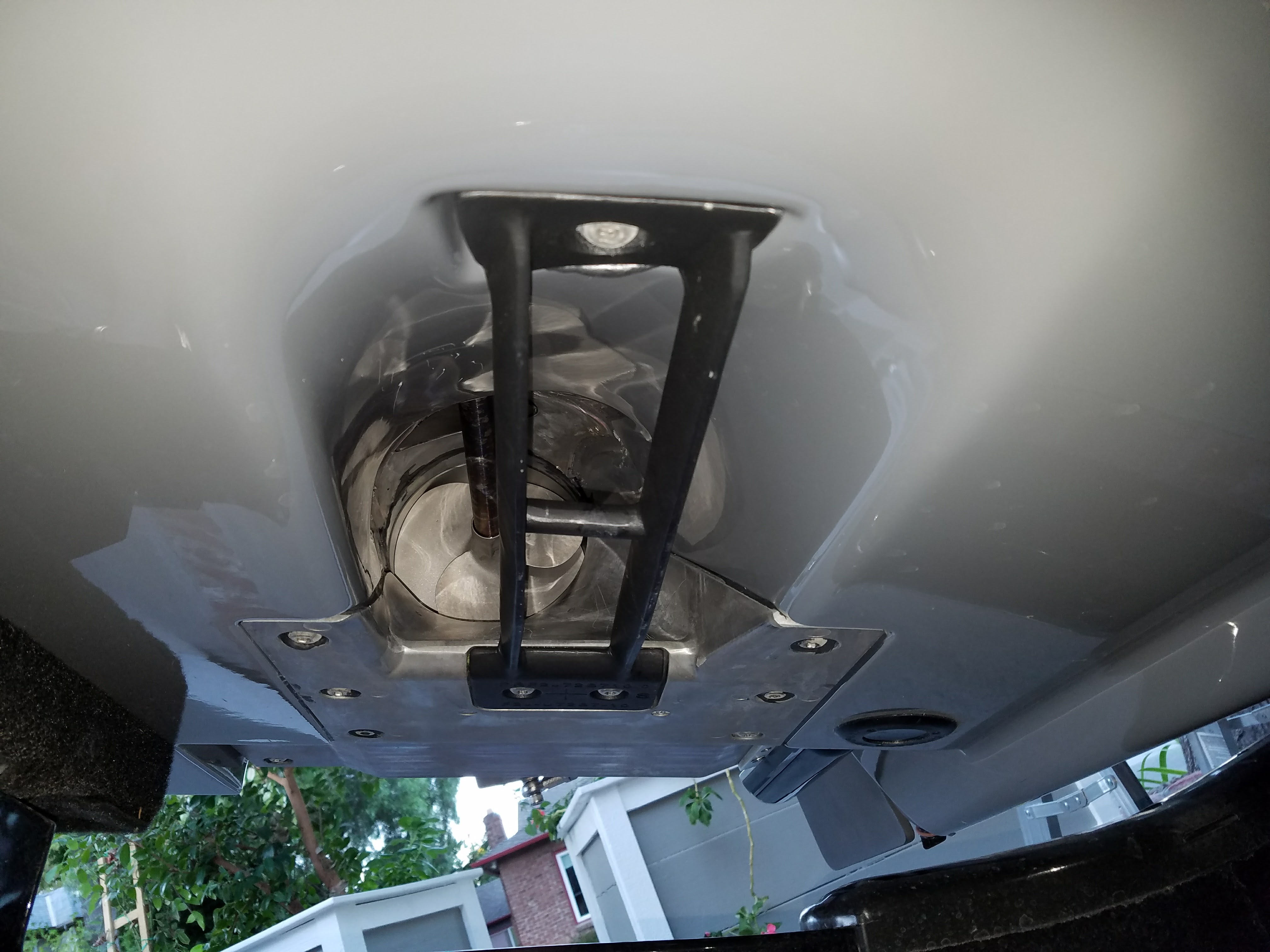

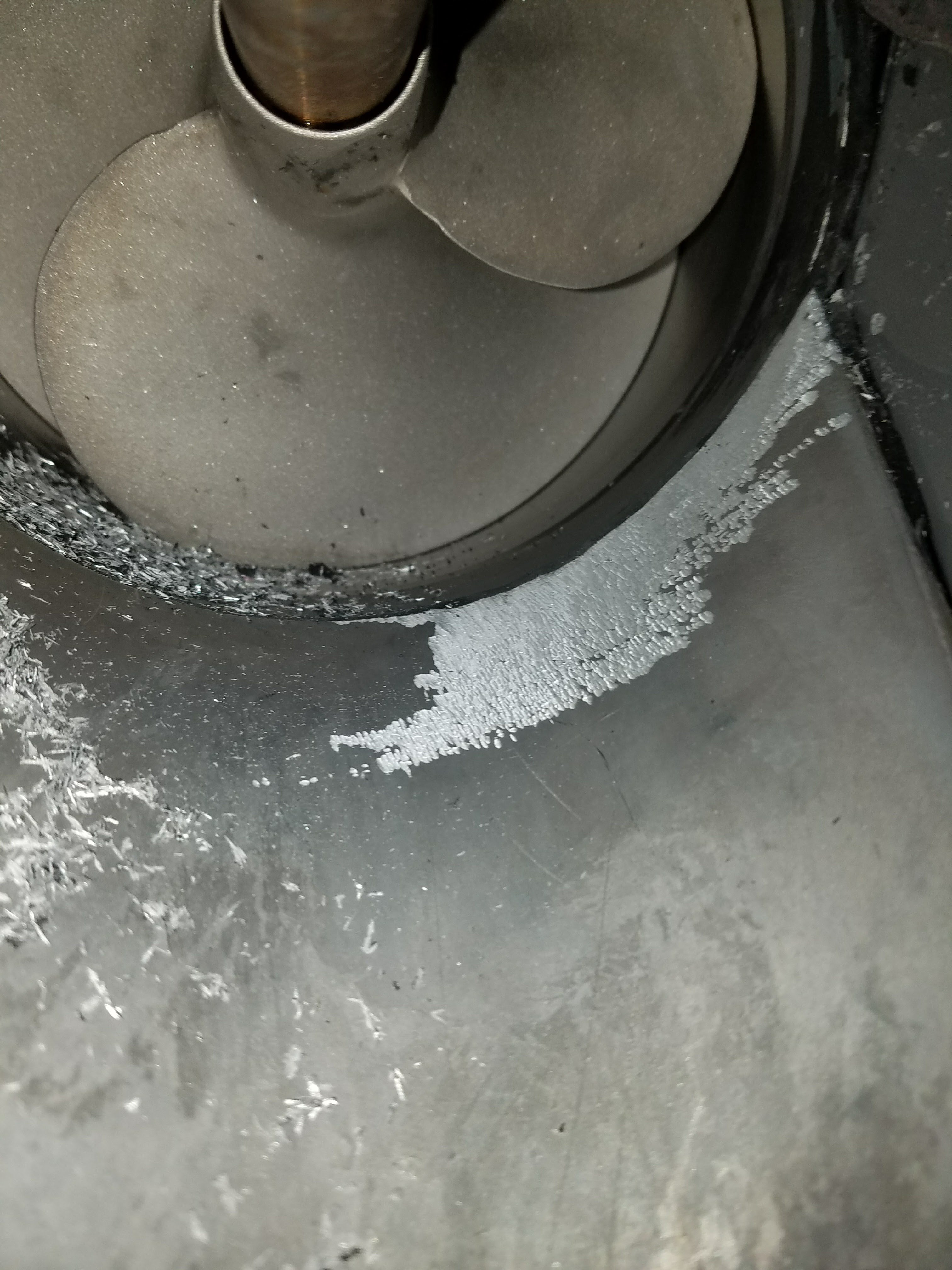

So I still haven't gotten a set of replacement grates so I didn't want to do anything crazy yet. I decided to "blueprint" what was there. I cut the crossbar out of the stock grates and knife edged the bars. I also cleaned up the intakes a bunch, there was a pretty good ledge that the water would have to go over on the bottom edge of the intakes right in front of the impellers. This picture shows the beginning of the "porting" work I did. After I smoothed out the ledge, I filled and smoothed the rest of the gaps and holes in the intakes.
The difference was absolutely noticeable! I did everything possible to try to get either engine to cavitate, they didn't. I could go full speed and crank the wheel into a hard 360 (just put the cobra jet fins on it) and come out of it without touching the throttles. A little slip, but no cavitation whatsoever. Top speed looked to be about the same, but the pumps definitely worked better at all speeds and rpm's. I have no idea if it was the minor grate mod, the minor intake tunnel smoothing or eliminating that ledge on the bottom side of the impeller opening that made it so different. Sometimes it's simply doing a whole bunch of "little" things that make something work more efficiently. In everything I do on cars, that's always been true. Attention to details makes the total package work better.
Anyway, I may still put a couple of wings or blades on those grates similar to the loader grates later. I'm just not sure I can improve on the way it's working right now. What I'm going to work on now is getting both the engines synced up a little closer power wise. I'm thinking about either making a nozzle insert for the port side or boring out the starboard side nozzle a little bit. Same as it was stock, the port engine still turns a little faster than the starboard side. I either need to put a little more load on the one, or free up the load on the other one to even them out a little more.
