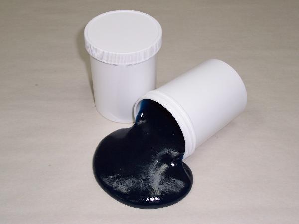

I have purchased the Island Racing slurry to change over from the grease. That was before @swatski found the mythical oem reccommended grease.

I checked it and it didn't look like there was any need to do more. But, when I got home I went about ordering the Island Racing Marine Liquid Pump Grease with the intent to clean the old grease out and change over to that before this season.
How will will you clean the grease out?
