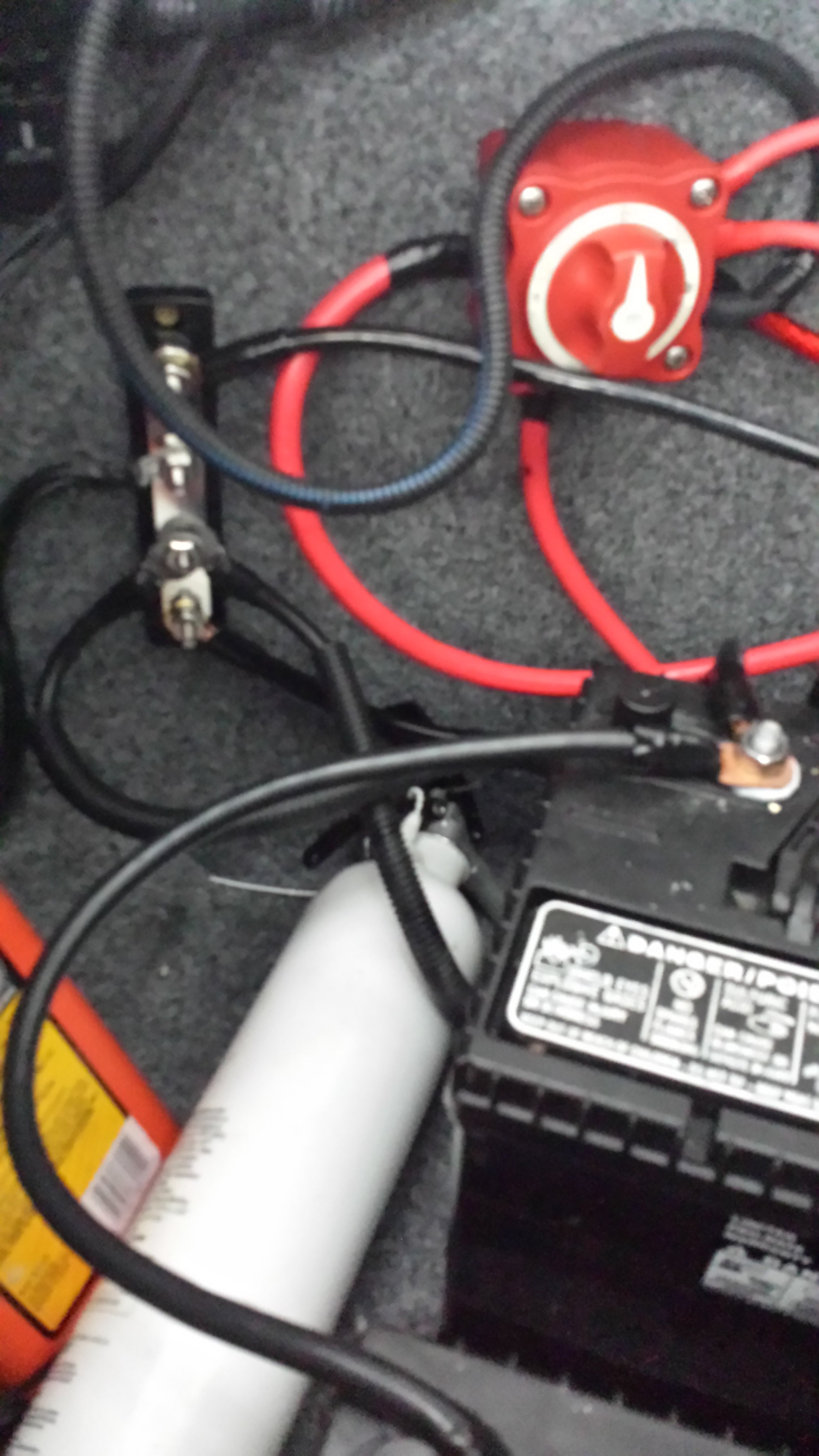

I used two group 27 batteries and two battery boxes. I chose to install one battery on each side of the boat to conserve storage and accessibility into each storage area.
This pic shows the wires from the batt switch and charger running to the starboard side.

Truth be told, I am moving one of my batteries to the starboard side as well @Murf'n'surf
thanks for the pics gents, I like the idea of a battery on each side, I think you just changed my mind
Be sure to use some properly gauged ABYC rated wire to extend your battery chargers lead to the far side. Some manufacturers sell extension kits for this purpose, ProMariner is one that does.
