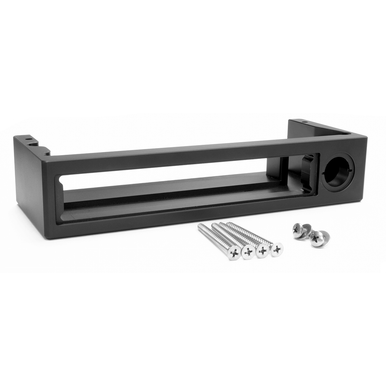

I bought this enclosure so I could mount the line leveller nicely beside the 420. Not cheap but very well made.
