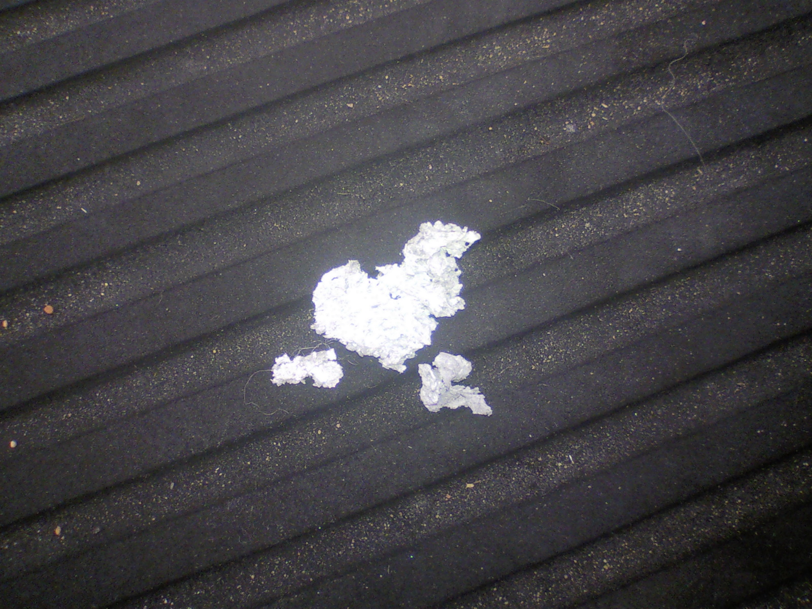

To snake the wires thru the tower: a piece of tissue, fishing line and a vacuum worked nicely (tip from a member here). I did break one wire on the sharp edge of the inside hole, upon completion of the wiring I squeezed in some silicone to try and prevent movement or wear against those edges later.
