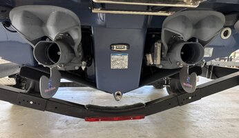

A comment from a customer who tried this on his boat
2024 FSH Sport H Cobra Jet Steering.
I installed the Cobra Jet steering fins and tested on the lake yesterday. One word….Amazing!!
The install is simple but I did spend time ensuring the fin was aligned (clocked) perfectly with the nozzle.
I noticed the difference the moment I backed off the trailer. Low speed control was much better. Obviously the helm control is the the way to go around a dock, but the Cobra fins provide more control in the absence of the articulating keel.
My complaints with this boat from the first day on the water were …constant drifting at trolling speed (3-5mph)…left turn every time you cut the throttle and come off plane…drifting when on plane at speed.
Tested yesterday with 10-15 mph winds with moderate rollers from wake boats and bass tournament. Trolling speed required very little to no input to maintain course! As a fisherman this was my primary concern. Problem eliminated!! The left turn dive also eliminated. Drifting at speed reduced significantly.
Is it worth it?? Absolutely!!
I hope this helps the others that have been asking about this system.
Thanks for the feedback. Your fins would definitely help with tracking in the open water, especially with towables. Based on Yamaha’s response, this might not be the right boat for us, but your fins are something we’ll consider once we sort it all out.
