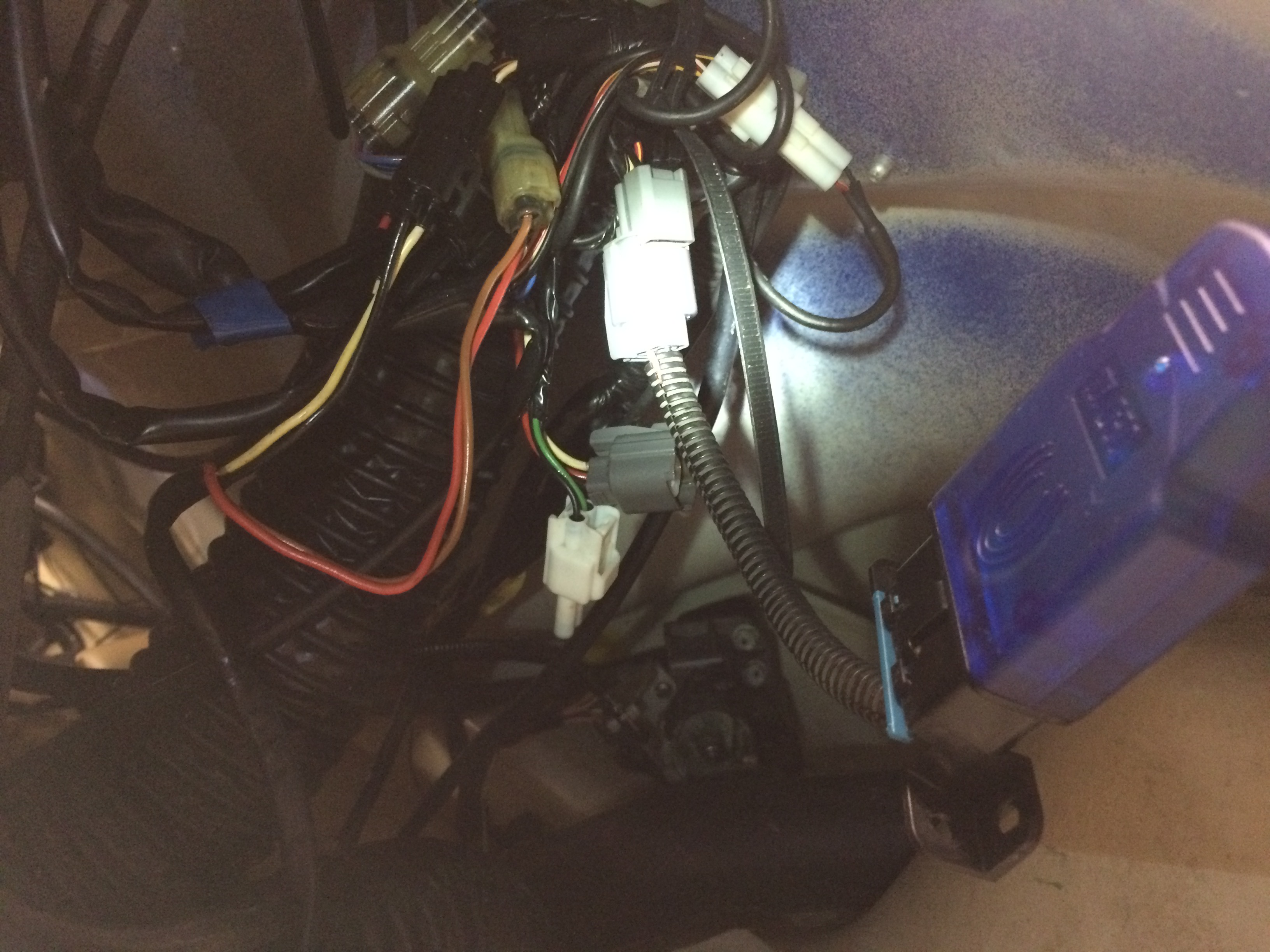

So here goes step four: inspect air box and air filter.
Well, they did a great job of stuffing this air box down in this ski. It’s sandwiched between the engine and fuel tank and has the fuel line running above it.
I started by loosening the hose clamp that secures the air intake hose to the throttle body. Then I cut a pair of zip ties that secure the main wiring harness to the air box and loosened the reusable one that secures the fuel line. There are six screws that hold down the lid to the air box. I removed those but was having difficulty getting the lid around the fuel line so I decided to just remove the entire air box. Also, I noticed that these six screws were greased. To me this was a sign that a mechanic had been in there at one time and anticipated doing maintenance in the future and wanted to make sure that these didn't corrode in place. So couple that with the preventative maintenance on the coils and I was pleasantly surprised. Anyway, The entire air box is held down to the hull at four points down below. However, only the two bolts on the right side need to be removed and the air box can slip out to the right leaving the two rubber mounts and boots on the left still in place. This would've been nice to know before I pulled those out first because those bolts aren't the easiest to reach and only having to remove two would've saved some time. Anyway, after some maneuvering, the air box was out.
So, once it was out it was easy to see that there was quite a bit of oil in the box on the engine side of the filter. Also, as @buckbuck noticed (stop cheating and looking ahead ) the air filter which was dry now due to lack of recent use, had at one point been soaked and splattered in oil. So that'll need to be replaced too.
At this point, once my battery arrives, my plan is to attempt to turn the engine over without the spark plugs and air box installed and see if it is actually locked up. I figured that it would give me more room to operate in there if I need to pull the engine.
