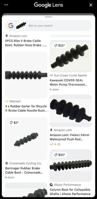

Kawasaki uses a rubber bellows on some of their cables. I've put them on most everything. I remove the cable end fitting, fill the bellows with grease, slide it on the cable, secure it in place with tie-wraps, then re-install the cable end. Be sure to count the number of turns on the cable end when you remove it. Kawasaki part number: 49016-3702 Cost is about $4.
This seems like a good idea if it would fit over the larger outside diameter of the fixed side of the cable. Can you confirm that it does? The holes look small.
Google search pic for others:

I was thinking about using billows a few years ago but could find anything that would work. I may order the Kawasaki ones, need to figure out a good way to fill with gear oil once it's installed.

I bought a couple of the Kawasaki bellows and I think they would be excellent. They fit the cable, but are too short for the 210 FSH. The throw on the cable is about 5”- 6” (sorry didn’t have a rule) and the bellows are 3 1/2” relaxed. Unfortunately they extend only about an inch.
There has to be a simple solution…something that extends over the exposed cable shaft that could be filled with marine grease to add another layer of protection against water protrusion. A longer bellow would work, I will be looking…

However @AZMark post above gave me the idea of doing a reverse image search. Certainly appear to be other potential options out there that could fit.
I ran the part thru AI (Perplexity) and it had ideas, but your search appears to turned up some better leads.
