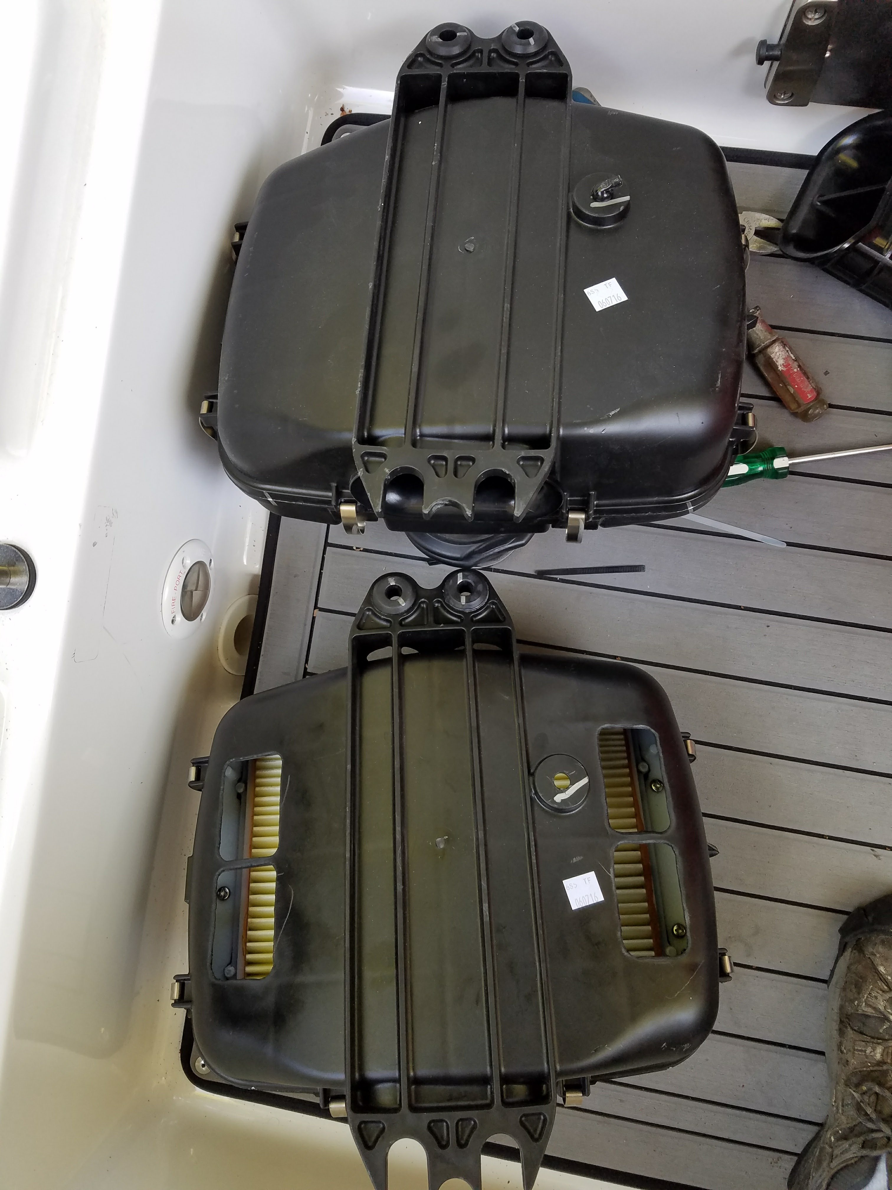

Q: Did you also remove the "snorkels" from the air filter boxes? I really like those cut-outs, never seen anyone doing this before!

Oh and yeah, I ripped those snorkels out of the intakes right away! As with the huge plastic "mufflers" in the exhaust. Those went bye-bye after my first time out with the boat. Along with the 4 feet of extra engine flush hose and about 6 feet of extra battery cables. WTF??? I'm from the auto industry. I've NEVER seen this kind of shoddy workmanship as I've seen so far on the building of this boat. Thankfully the engines are "pure" Yamaha.
