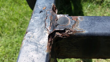

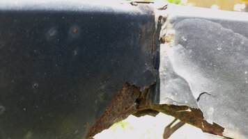

K So… the other day I swing under the back of the boat trailer to lubricate the caliper slider pins and I look up and see that the drivers side rear most slider spring bushing bolt has elongated the hole in the hanger-dammit. I inspected the passenger side rear most spring slider bushing and it is flat spotted-great. These bushings roll on a bolt, dry, no way to lubricate what a great plan for a boat trailer.

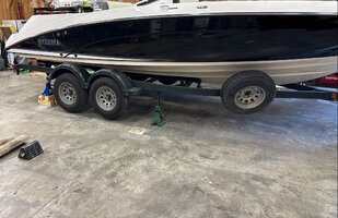

First thing was to get the boat trailer up on jack stands.
Get the wheels off…

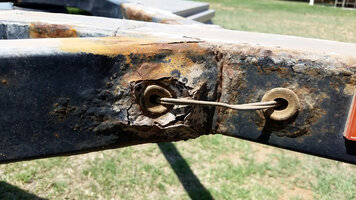

Okay let’s start with the worst one… put the jack under the axle to take the strain off of the pivot and remove the bolt, whoa! It’s worn through!

You can see that the bushing was so badly worn through and it had started on the bolt.
This the area of the spring where that flattened bushing was riding on … the bushing is supposed to roll as the spring gets long and shorter
This is how the spring looks in a wider view
