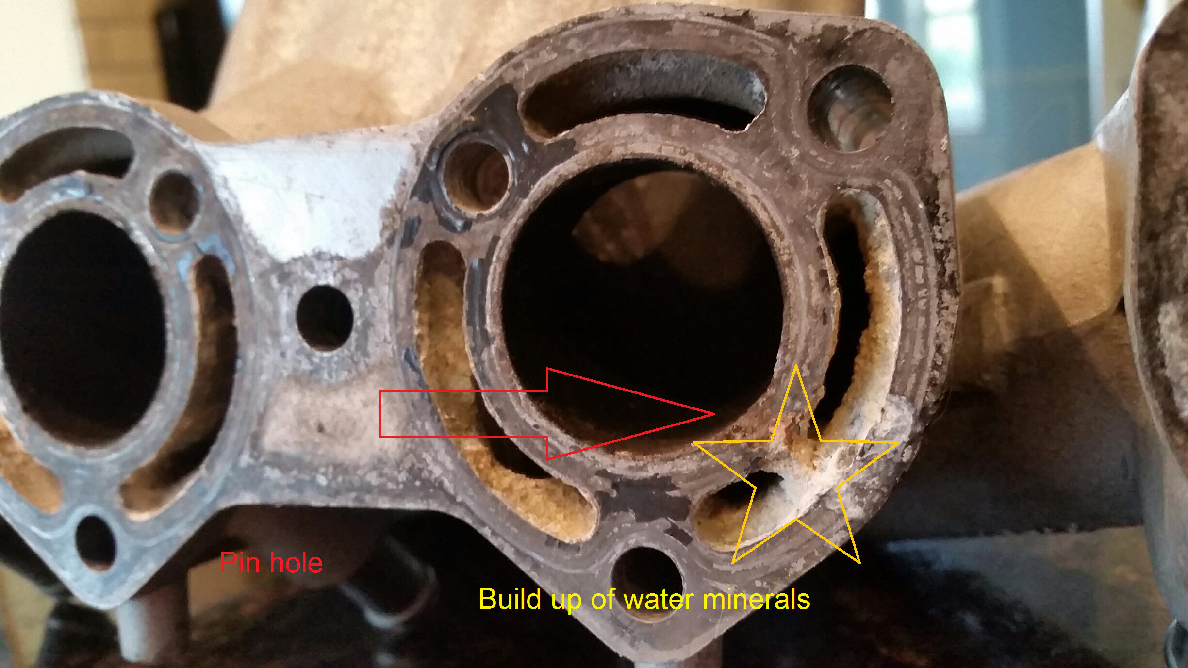

Has anyone's motor survived after having water mix with the oil . I caught it immediately after noticing the boat running odd drained all of the oil out from the oil drain bolt at the bottom of the motor and sucked out the oil tank . Ran it for 30 second intervals oil was clean did not want to run it on the hose due to water getting in . Pressure checked the oil cooler it was good than pulled the manifold off while the motor was in the boat , Port side allows for removal of the 20 bolts, two clamps and multiple water lines difficult but possible. I was kind of relieved that it was not a cracked block or warped head and in fact the manifold water jacket issue on cylinder 4 and 2 . Picked up parts off ebay reinstalled ran it on the hose no water in the oil the motor sounds perfect.
Things I learned during the process :
It may be possible to pull the 4 water supply lines off the manifold put a balloon on each of the aluminum barbs run the motor for 10-20 seconds with no water and watch it inflate if you do have breach on the water jacket ,it should force a lot of air into the breach this is a theory I'm not sure if pressure down the line could create the same effect. If you have water in the oil and want to trouble shoot the issue this could be a good way to check . looking at the carbon in the water jacket its obviously pumping exhaust into the jacket.
The gap is about the size of one of the pee holes and from how fast the piston fires 99% must be exhaust gas being forced into the water jacket and a slight bit of water is getting into the cylinder not causing hydro lock but making its way into the oil. How that is possible I'm not sure.
re installing the lower manifold is difficult getting the alignment pins on the lower part and the rubber hose connection to all align at the same time . With help from my son we took a pole with a thin rope and used it to pull the lower manifold up into alignment, gravity and the rubber boot create an issue that makes it impossible to line up without something helping.
This seems to be the Achilles heel of the Yamaha boats if your boat starts running odd check the oil it may not be a fouled plug if water thins the oil to much the engine will self destruct. I run in fresh and salt water about 270 hrs I did have a few runs that I sucked up a small branch, sea grass and lake weeds that created cavitation and an engine light to register it did not go into limp mode just prompted me to pull over and reach in the port to clean out debris. The breach could have been from running hot maybe it incinerated the aluminum . It looks like all the new models have a similar material on the manifolds .Thanks for the info on this site that helped me trouble shoot and find the solution!
